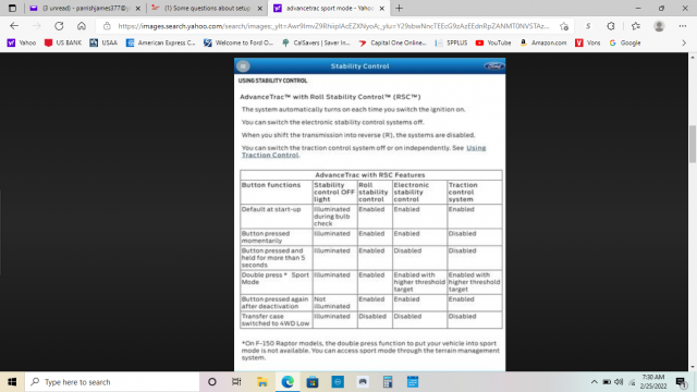

Les, I did notice in sport mode the Advancetrac seems to be more active. I'm not sure if it is the same as double tapping the button though. I kind of like the idea of going in to sport mode with the AWD, but still being able to leave the transmission in Normal Drive Mode.
Why in the world Ford didn't put any of this information in the owner's manual is beyond me. I too wondered why this information was not available for us. I googled 'Advancetrac sport mode' and found this chart. Hope it helps. Have a great day! Jim

Thanks for the info, Jim. That chart is very helpful, although I don't know if it's specifically aimed at the 2021 Edge ST (got a lot of hits for other Ford models, many older, when I googled Advancetrac sport mode). But it opened the door for me to dig into it a little deeper.
