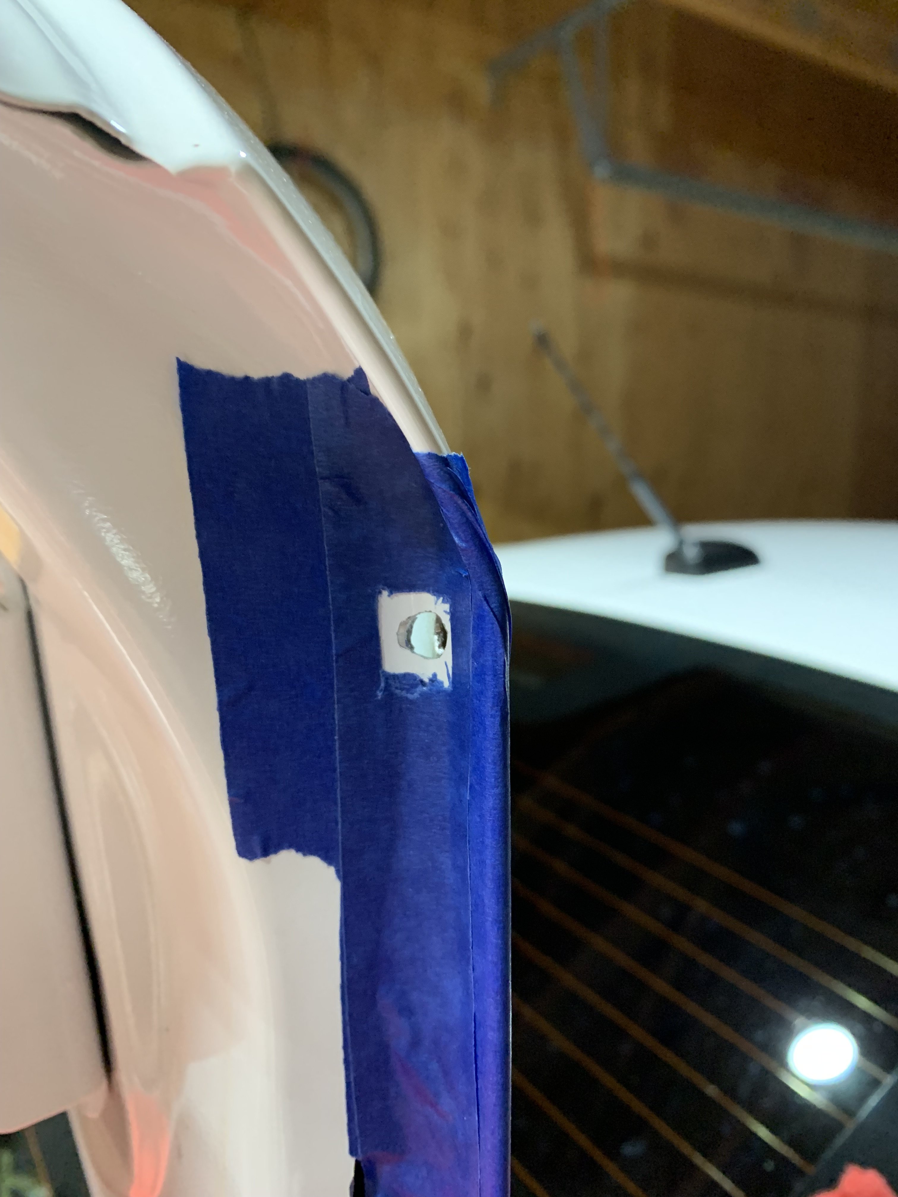

After your stomach settles from drilling holes in your semi-new car, tape off area that needs to be cut for cap screw clearance with SEVERAL layers of tape.(dremmels with cut off wheels can get very jumpy)
